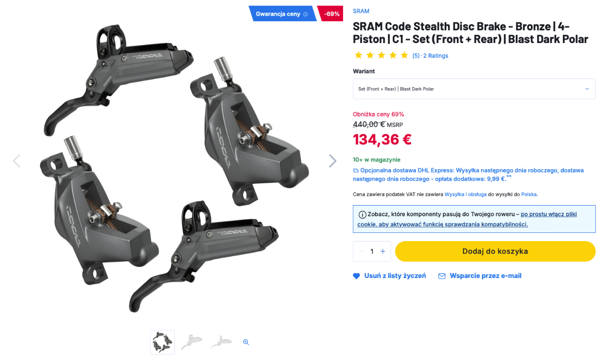

SRAM Code Stealth Disc Brake - Bronze | 4-Piston | C1 - Set (Front + Rear) | Blast Dark Polar https://www.bike24.pl/produkty/740720?sku=2684102
