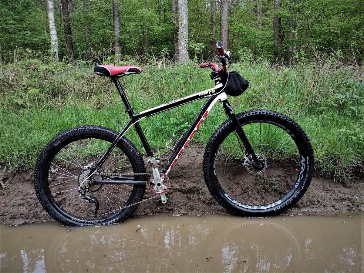

Sobek82 Napisano 18 Maja 2021 Napisano 18 Maja 2021 Zwykła rama alu 29er z 2k15, z tyłu 27,5 z oponą 2.8, przód 29 z oponą 3.0 Pozdrow'er

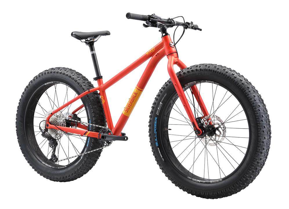

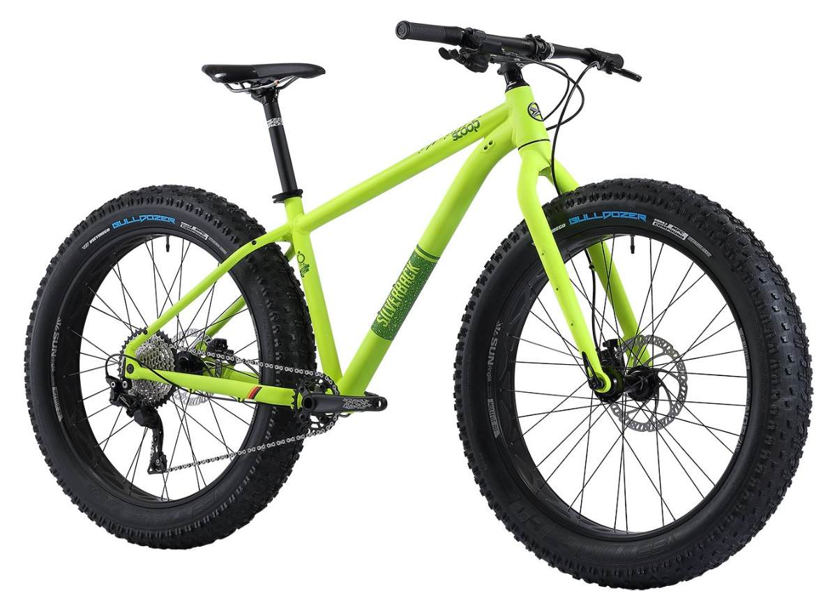

zwiadowca88 Napisano 24 Maja 2021 Autor Napisano 24 Maja 2021 Mam pytanie odnośnie podzespołów, który z poniższych opcji jest lepszy jeśli chodzi o stosunek cena/jakość. Silverback Scoop Deluxe 2021 (zielony) (4.999 zł) RAMA 26" Butted 6061 Aluminium, Tapered 1-1/8"-1.5" headtube, 197mm x 12mm Thru Axle Dropouts, 100mm BB width WIDELEC SBC Alloy, 26" Rigid, 150x15mm Thru Axle OBRĘCZE SUNringle Mulefut 80SL, Tubeless Ready PIASTY SUNRingle SRD TA, 15x150mm F / 12x197mm R OPONY VEE Tire Bulldozer 26x4.7", Foldable , Tubeless Ready, 72TPI MOSTEK Surface Alloy Stem, 31.8mm, Rise 6°, with stainless steel bolts KIEROWNICA Surface Alloy Handlebar, Dia:31.8mm, Backsweep:9°, Rise 5mm; SZTYCA Surface Aluminium, Black SIODEŁKO Surface Ergo, Cromo Rails HAMULCE Tektro MD-M275 Hydraulic System, Rotors: 180mm/160mm, 6 Bolt MANETKI Shimano Deore 10 Speed, Black TYLNA PRZERZUTKA Shimano Deore M6000 10spd, Shadow Plus Long Cage KASETA Shimano HG-500-10 10 Speed 11-42t MECHANIZM KORBOWY Surface Forged Alloy Crankset, 28t SUPORT 120mm BB shell, Surface BSA24 BB set DOPUSZCZALNA ŁADOWNOŚĆ 120 KG WAGA 15,24 kg Silverback Scoop Fatty 2021 (pomarańczowy) (5.999 zł) RAMA 26" Butted 6061 Aluminium, Tapered 1-1/8"-1.5" headtube, 197mm x 12mm Thru Axle Dropouts, 100mm BB width WIDELEC SBC Alloy, 26" Rigid, 150x15mm Thru Axle OBRĘCZE SUNringle Mulefut 80SL, Tubeless Ready PIASTY SUNRingle SRD TA, 15x150mm F / 12x197mm R OPONY VEE Tire Bulldozer 26x4.7", Foldable , Tubeless Ready, 72TPI MOSTEK Surface Alloy Stem, 31.8mm, Rise 6°, with stainless steel bolts KIEROWNICA Surface Alloy Handlebar, Dia:31.8mm, Backsweep:9°, Rise 5mm; SZTYCA Surface Aluminium, Black SIODEŁKO Surface Performance Comfort HAMULCE Shimano BL-MT501 Hydraulic Disc brakes, 180mm/160mm rotors MANETKI Shimano Deore 11 Speed, Black TYLNA PRZERZUTKA Shimano Deore SGS, 11 spd, Shadow Plus design KASETA Shimano Deore 11 Spd , 11-51T MECHANIZM KORBOWY Surface forged alloy, 170/175mm, 28T SUPORT 120mm BB shell, Surface BSA24 BB set DOPUSZCZALNA ŁADOWNOŚĆ 120 KG WAGA 14,57 kg Co prawda jest to powyżej zakładanej kwoty, zwłaszcza w przypadku wersji Fatty. Ale ewentualnie mógłbym poczekać trochę i zakupić akcesoria w późniejszym terminie. Obydwa modele różnią się jedynie osprzętem. Pytanie czy warto dopłacić. Co do Mongoose Argus Sport 2021, niestety model ten nie jest dostępny w Polsce i zapowiada się iż długo jeszcze nie będzie.
