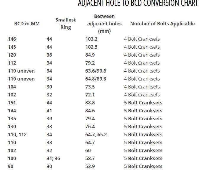

JWO Napisano 2 Lipca 2021 Napisano 2 Lipca 2021 34T nie da rady dla bcd130 Cytat The smallest chainring you can get for 130mm BCD is 38t. Everything you need to know about 110 and 130 BCD Cranksets – Corbah
