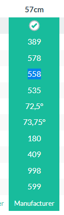

558 -  a inne wymiary? mam dlugosc nóg (od ziemi do pachwin) 83 cm. a rozmiar 57 według producenta jest na wysokosc nog 84-87
"As a rule of thumb, road bikes with a high ratio of stack to reach (1.5 and greater) are best for less flexible athletes or those with longer legs and shorter torsos; road bikes with a lower ratio of stack to reach (1.5 and lower) are best for more flexible athletes or those with longer torsos and shorter legs."  jest to w miare prawda?
bo w tym rowerze w rozm. 57 wychodzi gdzies 1.48
